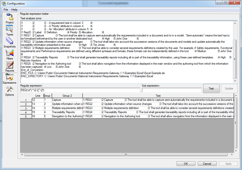

You can test regular expressions using the Expressions pane, located in the Configuration Dialog. To test regular expressions, follow the instructions below:
  1. On the Expressions pane, enter project document source file text to use for testing the expression in the Text analysis control. You can also use the following options in the File menu on the Expressions pane to import text from an existing project document source file:

  2. Enter a regular expression in the Regular expression control and, if necessary, a sub-regular expression in the Sub expression control.
  3. Click the Test regular expression button.  If there are matches to the expression, they will be displayed in a table.
The Expressions pane also displays the values for any groups you have specified in the regular expression using parenthases. The Text field displays the text of the line containing the match, as shown in the image below:
