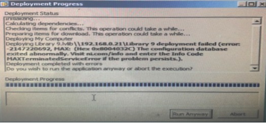

When I try to deploy them from the Project Explorer window I getting error -2147220692. Note: I am using network shared variables in my LabVIEW application.
Deployment failded (error:-2147220692, MAX: (Hex 0x8004032C) The configuration database exited abnormally. Visit ni.com/info and enter the Info Code MAXTerminatedServiceError if the problem persists.
​Following a screenshot of the error:
This error is related to NI Measurements & Automation Explorer (MAX). Try the following steps to resolve this issue:
1. Try a reset of the NI MAX database File.
2. If error persist, follow the procedure indicated in the document MAXTerminatedServiceError When NI MAX Database Exited Abnormally.
An unexpected computer shutdown or crash can cause the NI MAX Database to become corrupt and require a reset of the database. You can check the Windows Event Logs for any improper shutdowns of the system.
