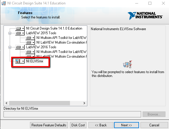

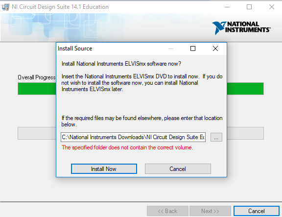

I have downloaded Circuit Design Suite Education Edition from the web and I am currently trying to install it. However in the installation process I receive a prompt asking to insert the NI ELVISmx software DVD even though I am downloading from the internet.
I will not be working with the NI ELVIS, so I am not interested in the ELVISmx software. What should I do?
You can click Cancel, this should prevent from installing the ELVISmx software.
The ELVISmx software is selected by default to be installed with Circuit Design Suite. You can uncheck it in the features to install to prevent the prompt shown previously.
