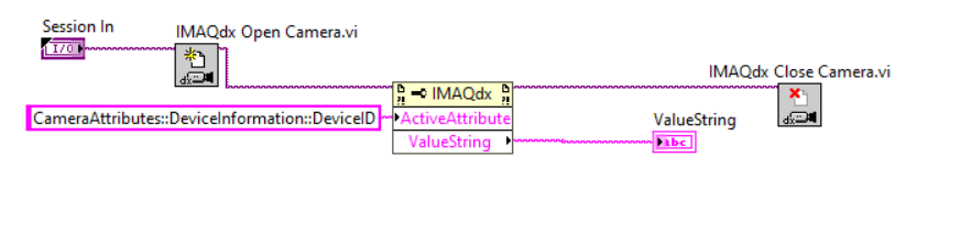

My system has multiple cameras connected to it, and each one needs to perform a different task. In order to tell them apart, I would like to read the Serial Number of each camera programmatically. When I try to use an IMAQ Property Node to read the Serial number, however, I get a number that does not match what is printed on the camera.
How can I read the Serial Number of my camera from LabVIEW?
For some cameras, the Serial Number is called a Device ID. In order to read the Device ID, you can implement the following code:
It could also be that you need to modify the attribute entry here. If the above doesn't work for you, try replacing that string with the following: CameraAttributes::DeviceControl::DeviceID
The Device ID will come in as a string, and can be converted to a different datatype as needed.
