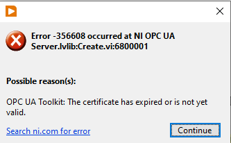

  • I am using the LabVIEW 2017 OPC UA Toolkit to create a client VI that will communicate with an external OPC UA server (like those hosted on another PC or a PLC). When I call the Connect VI from this toolkit to connect to the server.
  • When running the Data Access Server.vi included in the OPC UA Demo.lvproj (LabVIEW examples).
After following any of the steps above, I get one of the following errors even when I specify on both my client and server to not use a security policy:
  • Error -356608: The certificate is expired or is not yet valid.
  • Error -356610: The certificate is not trusted

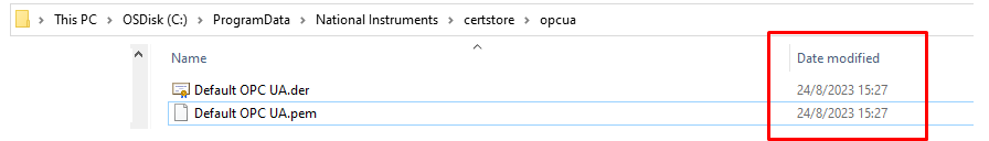

  • When creating a server (NI OPC UA Server.lib:Create.vi) or client (NI OPC UA Client.lib:Connect.vi) a certificate file might be used (this is provided through the server certificate file and client certificate file inputs of the VIs previously mentioned). If no certificate is provided, a new default certificate is generated and used. In both scenarios (provided or default certificate) the certificate must not be more than 4 years old as explained in the Creating or Renewing OPC UA Certificates Using the LabVIEW OPC UA Toolkit article. Make sure the certificate used by the server or client has a valid date.
When certificates are generated, they use the current system time as a timestamp. As part of the handshake process to set up an OPC UA connection, the certificates are exchanged and evaluated by the receiving system. Part of this evaluation is checking to make sure the certificate's timestamp is valid.
If the server's certificate has a timestamp later than the client's current time, for example, the client will recognize that this timestamp must be incorrect, causing it to reject the certificate and abort the connection. Errors like the ones listed above can be thrown to alert you that the certificate is not valid.
