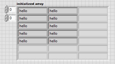

    • In the example below, there are 5 rows and 2 columns defined in the 2D array. The array will be filled with string datatype elements, initialized to all say "hello."
  1. Right-click the initialized array output of the function and select Create Indicator.
  2. On the front panel, hover over the bottom-left resizing node of the array indicator until the multi-dimensional array resizing node appears. Resize array.
    • Resizing to larger than your specified dimensions is fine. When the program is run, only the array elements within your specified row and column dimensions will be initialized.
  3. Run the VI to initialize your 2D array.
