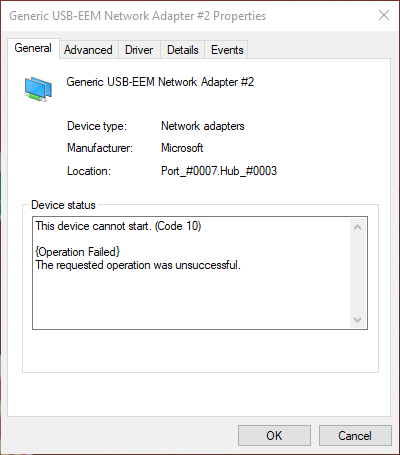

  • When I plug in my CompactRIO device using USB, I don't see any pop-up window showing that the device is detected. I am not able to see it under Network Devices in NI MAX either. When I open up Windows Device Manager, I see my device represented as "Generic USB-EEM Network Adapter" under the "Network adapters" dropdown.
  • When I open the properties of the device, I see an error that says "This device cannot start. (Code 10)".

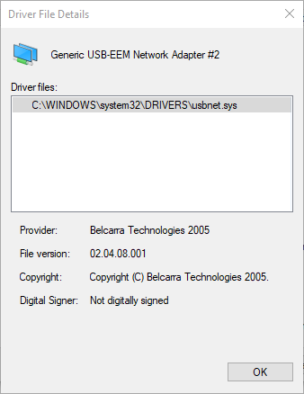

  • When I look at my driver details it shows my driver file as C:\WINDOWS\systems32\DRIVERS\usbnet.sys

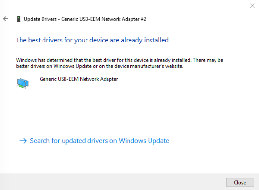

  • Manually associate the network adapter driver with the NI CompactRIO driver. The adapter should show up as an NI-USBLAN adapter. If you see the dialog shown below proceed to the next troubleshooting step.

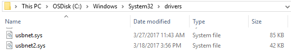

  • Replace the usbnet.sys file in your host computer by following these steps:
  1. Open the Windows File Explorer and navigate to C:\Program Files (x86)\National Instruments\CompactRIO\Staging\USBLAN\Win7\amd64. You will see a file named nationalinstrumentsblan.sys.
  1. Open another File Explorer window and navigate to C:\Windows\System32\drivers. Find usbnet.sys and rename it to usbnet.sys. Finally make a copy of nationalinstrumentsblan.sys and name it usbnet.sys, then move it into C:\Windows\System32\drivers.
  1. Once you have replaced the usbnet.sys with a renamed copy of nationalinstrumentsblan.sys, reconnect your device.
