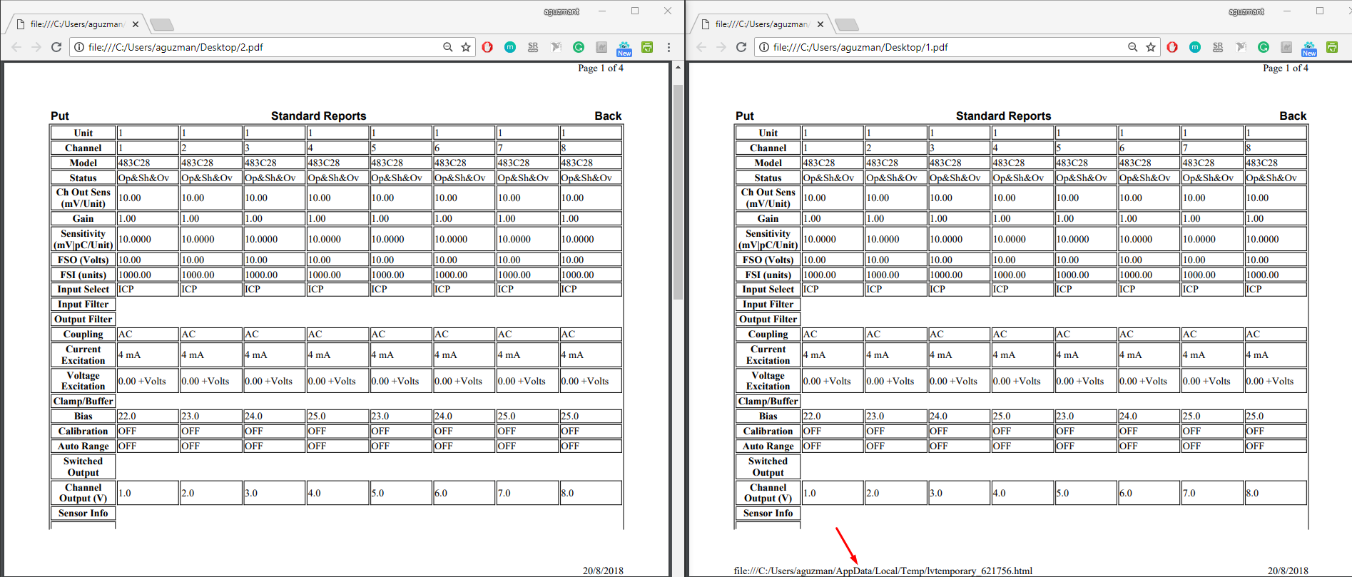

I am printing an HTML report with the LabVIEW Report Generation Toolkit VIs and I do not want my report to show the path/URL footer. How can I disable it?

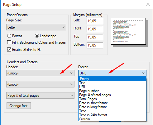

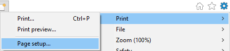

In order to remove the headers and footers, you need to modify this setting in the page setup for the Internet Explorer default printer as follows:
  1. Go to Settings >> Print >> Page setup…
  1. Select -Empty- from the dropdown boxes below Header and Footer
