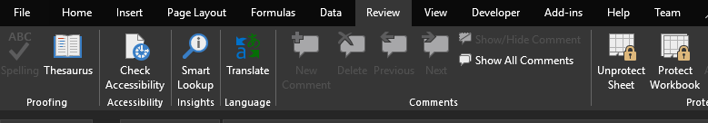

1.- Un protect the Excel sheet temporarily by opening the Excel sheet, going to the Review tab, and clicking the Unprotect button. You may be asked for a password.

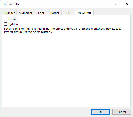

3.- Right click the range of cells and click Format Cells...
4.- Select the Protection tab in the Format Cells dialog window.
5.- Uncheck the Locked checkbox.
6.- Go to the Review tab again to protect your Excel sheet.
