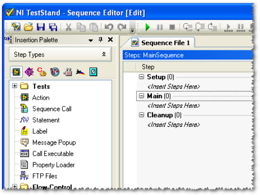

My menu bar or another interface item is missing in TestStand, as shown in the image below. How can I recover the missing interface item?
You can restore the Sequence Editor window through the following steps:
  1. Navigate to Configure»Sequence Editor Options from the main menu to open the Sequence Editor Options dialog box. (if the menu bar is missing, use Alt+C to launch the Configure menu)
  2. On the UI Configuration tab, select either Large Screen Example or Small Screen Example, then click Load Selected.
The default UI configuration will be loaded.
It is possible to move items out of the Sequence Editor window by dragging them, which is why they may appear to be missing.
