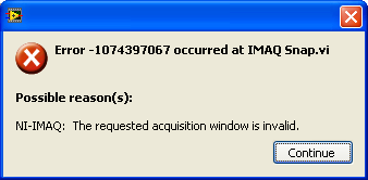

I am able to snap and grab in Measurement & Automation Explorer (MAX) without any problems but whenever I snap or grab in LabVIEW I get the following error:
Error -1074397067 occurred at IMAQ Snap.vi (or IMAQ Grab.vi, IMAQ Grab Setup.vi, etc.)
Possible reason(s): NI-IMAQ: The requested acquisition window is invalid.
LabVIEW usually returns this error because the IMAQ camera initialization requires different acquisition window parameters than are currently in the the camera file. For example, we would see this error when MAX sets a width value of 318 and the initialization call in LabVIEW sets the width to 320.
To address this, specify the acquisition windows attributes explicitly in LabVIEW, or make edits to the camera file.
