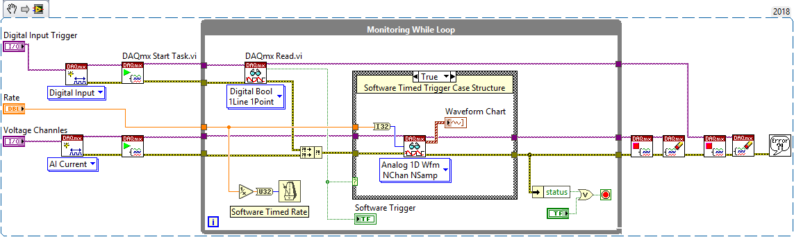

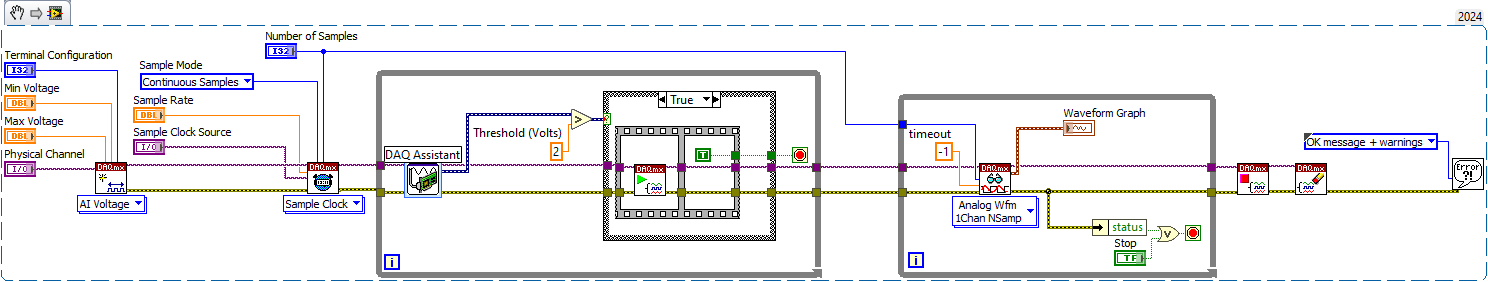

A software-timed trigger can be implemented by continuously monitoring the status of an input signal within a while loop. When a specific condition is met—such as a threshold being crossed—the loop exits and the DAQmx Start.vi is called to initiate the desired task.
The following code snippet demonstrates how to create a software-timed trigger using an analog input. In this example, an analog voltage value from the DAQ Assistant is monitored, and once it exceeds a defined threshold, it triggers a separate DAQmx Analog Input Task.
Note: The DAQ Assistant VI can be substituted with a digital input task if your application requires digital triggering instead.
Block Diagram:

False Case:
The software timed configuration will run at one rate determined by the computer's Operating System and how it prioritizes the tasks currently ongoing. In this way, we should expect a high latency on the application.
