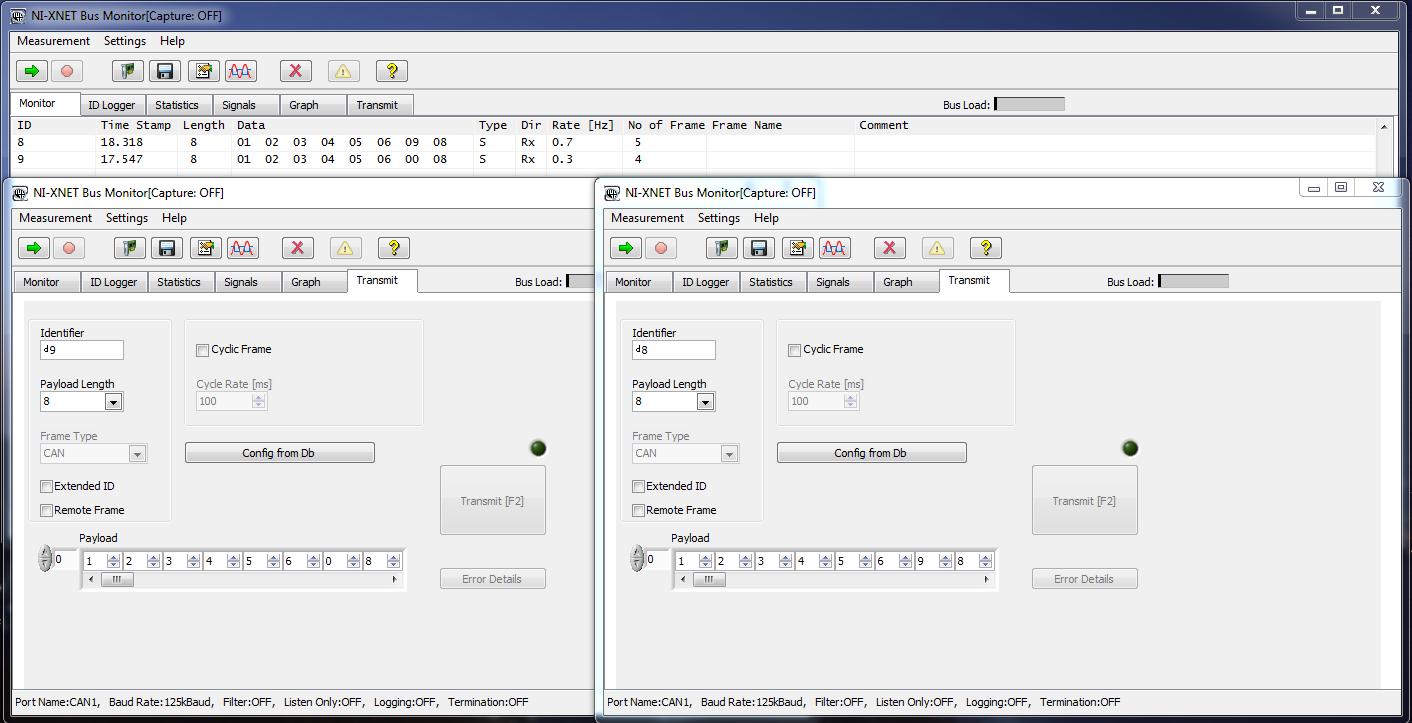

Can I setup 2 or more transmit ID’s using the NI-XNET Bus Monitor transmit tab?
You can have open multiple instances of the NI-XNET Bus Monitor to send multiple frames for different IDs.
In the following example, both ports of a NI-XNET USB-8502 device are connected in a loopback mode. CAN1 is used to send the frames to the 2 IDs, and CAN2 is used to read the frames.
