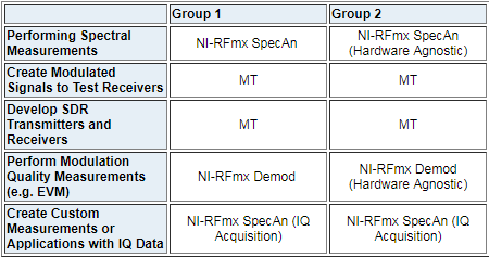

If you are currently using NI RF Spectral Measurement Toolkit or Modulation Toolkit:
NI-RFmx SpecAn provides all the measurements that are in the NI Spectral Measurements Toolkit (NI SMT) along with other features. NI-RFmx Demod provides a simplified measurement experience for modulated signals. The NI Modulation Toolkit (NI MT) provides generation capabilities, as well as low level code for Software Defined Radio (SDR) applications.
Refer to the table below to determine whether to use NI-RFmx or NI MT for your application. NI SMT is not recommended for new designs. As the appropriate version of RFmx depends on which hardware it is used with, please first identify whether your hardware will require the Hardware Agnostic variety with the following list:
Group 1: Default Personalities
  • NI 5663E Vector Signal Analyzer
  • NI 5665 High-Performance Vector Signal Analyzer
  • NI 5668R High-Performance VSA and Spectrum Analyzer
  • NI 5644R, 5645R, 5646R First-generation Vector Signal Transceiver
  • NI 5840 Second-generation Vector Signal Transceiver
Group 2: Hardware Agnostic Personalities
  • NI 5661 Vector Signal Analyzer
  • NI 5667 High-Performance Spectrum Monitoring Receiver
Other hardware not listed in Group 1
