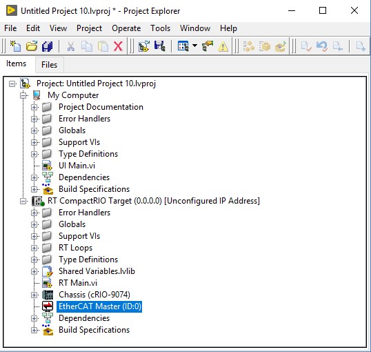

  • I am looking for the EtherCAT configuration file for my EtherCAT slave device. Where is this XML file located on my PC?
  • I want to update the EtherCAT slave list in LabVIEW which is shown below:
The XML file can be located in one of these folders:
C:\Program Files (x86)\National Instruments\LabVIEW XXXX\resource\Framework\Providers\indcomecat\DD where XXXX is the LabVIEW version you're using
C:\Program Files (x86)\National Instruments\Shared\IndComECAT\DD
Deleting the XML file located in one of the folders above and restarting LabVIEW will update the EtherCAT slave list.
