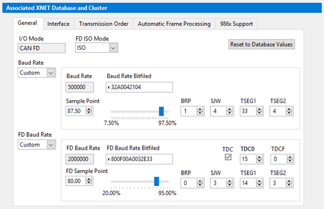

VeriStand 2019 supports XNET implementation that supports CAN FD and CAN FD with Baud Rate Switching I/O modes. This implementation also allows calculating and using custom baud rates for a CAN interface.
VeriStand 2018 SP1 or Earlier
For VeriStand 2018 SP1 or earlier, the native XNET custom device does not support custom baud rate entries for CAN FD. The workaround below only works for setting custom baud rate for normal CAN.

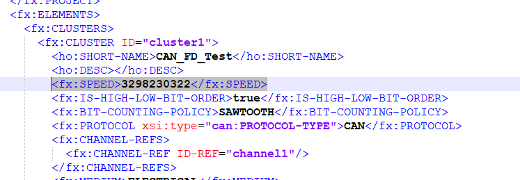

When I/O mode is CAN FD + BRS, system definition only has the FD portion. VeriStand will use the normal non-FD baud rate directly from the database and will not let you edit it in the custom device. You must use the custom baud rate for the normal section directly into the XML of the fibex file, as shown below:
