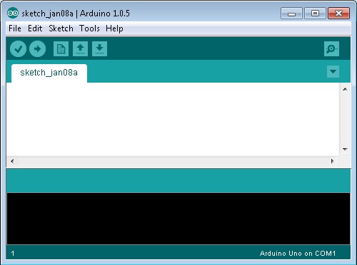

  1. Take the Init.vi out of auto-detection mode by wiring up the Arduino VISA resource and baud rate. Right-click on the top left terminal of the Init.vi in and select Create » Constant. This will create a VISA constant. Select the COM port your Arduino is connected to from the drop down menu. The correct COM port to use will be shown in the Arduino Integrated Development Environment (IDE) when you flash the LabVIEW Interface for Arduino (LIFA) firmware to the Arduino board.  Right-click on the terminal underneath the VISA resource and select Create » Constant again. In this box set the baud rate for your Arduino. The default for most cases will be 115200.
