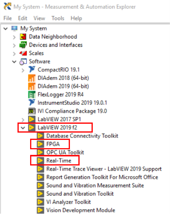

When I open a LabVIEW project including a Real-Time target like a CompactRIO (cRIO), CompactDAQ (cDAQ) or Real-Time PXI, I see a yellow exclamation mark next to my target. When I click on the target, I get the following message, but NI License Manager shows that all of my software is licensed.
Unsupported Item
The plug-in for the selected item is not installed on your system or the plug-in has an expired license. Please contact National Instruments.
The most common cause for this is the LabVIEW Real-Time Module not being installed or having an incompatible version. The LabVIEW and LabVIEW Real-Time versions must match. If you are using a cRIO and the FPGA, you should also make sure the LabVIEW FPGA Module is installed and matches the LabVIEW version or you will have similar issues accessing the device's FPGA. To solve the issue, review the suggestions below:
  • Open NI Measurement and Automation Explorer (MAX) and expand the Software tab. Ensure you have the Real-Time Module listed under the version of LabVIEW you are using. If you have a CompactRIO, ensure that you have installed the FPGA Module so that you can program the FPGA as well.
If you do not have these modules, they can be downloaded from the LabVIEW Real-Time Module Download Page and the LabVIEW FPGA Module Download Page.
  • Ensure you have compatible versions of any required drivers installed. For example, if you have cRIO or cDAQ, you can check the Software Support for CompactRIO, CompactDAQ, Single-Board RIO, R Series, and EtherCAT page to find the LabVIEW and driver support.
  • Update the NI CompactRIO driver to the latest version compatible with the version of LabVIEW you are using. Please refer to CompactRIO Device Driver and LabVIEW Version Compatibility to see which versions are compatible. If the newest compatible version is already installed, remove it and install it again.

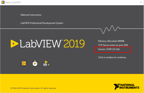

  • This issue can also occur if you open your project in LabVIEW 64-bit. Not all versions of LabVIEW FPGA or Real-Time Module have 64-bit versions. If you are using 32-bit versions of either Real-Time or FPGA module, ensure that you are opening your project in LabVIEW 32-bit. You can check the version and bitness in LabVIEW by selecting Help >> About LabVIEW
Note: LabVIEW FPGA Module 64-bit is available as of version 2018 and LabVIEW Real-Time Module 64-bit is available as of version 2021
