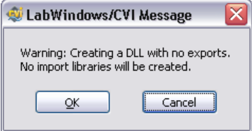

After opening a project in LabWindows/CVI, I try to create a dynamic link library (DLL) from my source. However, during the compiling and linking process, I receive the following error message: Warning: Creating a DLL with no exports. No import libraries will be created.

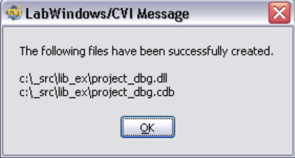

Additionally, no import library (LIB) is created as part of the process; only a DLL and a .cdb file are created as the following screenshot illustrates:

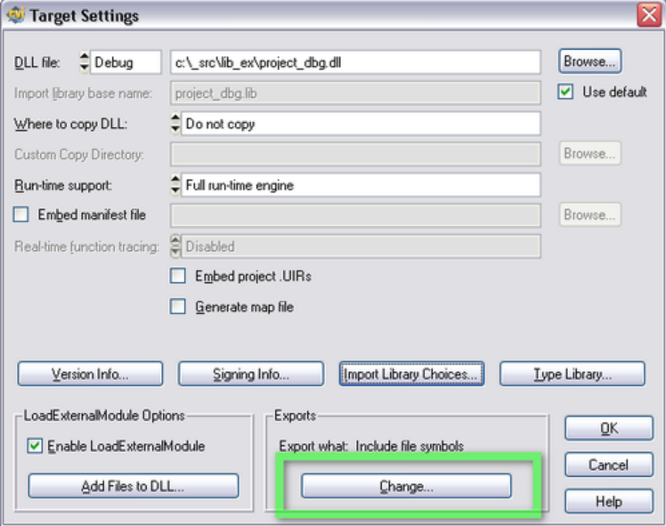

  2. Select Build»Target Settings to open the Target Settings dialog box.
  3. Click the Change button under Exports to open the DLL Export Options dialog box.

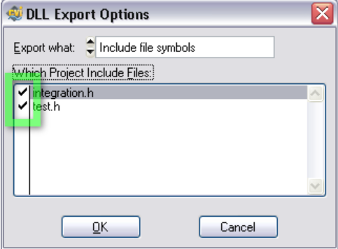

4.Place check-marks beside the header files from which you want to include symbols.
5.Click OK to close the DLL export Options dialog.

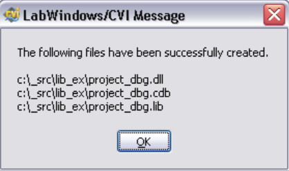

8.Confirm through the subsequent LabWindows/CVI Message dialog that your .dll, .cdb, and .lib files were created.
