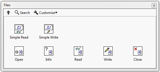

I am measuring an analog sound signal using a DAQ card and DAQmx functions. How can I save or record this sound signal for later analysis?
Native LabVIEW functions allow writing waveforms into a WAV file. The Sound Palette contains multiple VIs to Open, Write, and Read WAV files. See the help description for the LabVIEW Sound VIs for further details.
Figure 1: Sound VIs Palette
