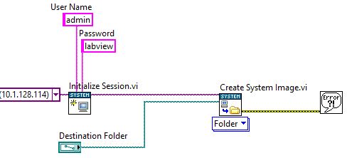

I am using the Replication and Deployment (RAD) utility to retrieve an application image from a RIO. When I click 'Retrieve', I get Error -2147220314: The operation failed because of insufficient permissions.
How can I resolve this error?
This error could be caused by a variety of issues but a possible fix to the problem is to try saving the image to a different folder on your development machine using the RAD Utility.

  • Run the RAD Utility Source Code
  • Use the Sys Config API to obtain an image (‘Initialize Session’ and ‘Create System Image (Folder)’)
