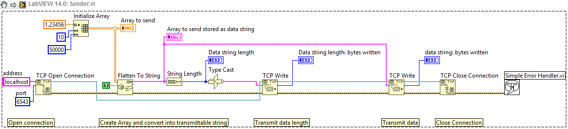

I have stored measurement data in an array of 10x50,000 elements. I want to transfer this data from LabVIEW to another computer. As far as I know the TCP/IP protocol caps out at 65,535 bytes. Is there a way to compress the data before sending it over or any way to transfer this huge amount of data in real-time?
LabVIEW's TCP Write Function and TCP Read Functions are high-level functions that automatically take care of transmitting the data in a way suited for the underlying network connection.
In the example described above the TCP Write Function will split the user data and transfer it using multiple network frames/packets.

This is an example on how to transfer the array from the issue described above using LabVIEW's TCP functions. Execute recipient.vi first, then sender.vi.
