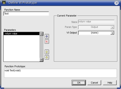

  2. In the window that appears, navigate to the Source Files section, select the main VI that you want to run and add it to the Exported VIs section.
  3. When the Define VI Prototype window appears, note the Function Name, and verify that the options match the image below, then click OK.
  1. Now select the Advanced section and check the box for Use embedded version of run-time engine (Note: this option is only available in LabVIEW for Linux).
  2. Make any other changes you would like to the Shared Library configuration, and then click Build at the bottom of the window.  This will generate a number of files including a .h and a .so file.
  3. In the same directory as the .h and the .so files, create a new C file (test.c in this example) with the following contents.
Note: You will need to replace SharedLib.h with the name of your .h file and Test() with the name of the main function that you set for the main VI in the Shared Library build specification.
