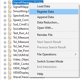

  • When you need to view or analyze only a few parts of a large data file, it is a good idea to use the register data option to open the data file.
    • Right click the desired file and select Register Data. This feature loads all the information about the file (number of channels, their names and all their properties, etc.), but does not load the actual data until you view or analyze it. With this feature, you can load only the data you need from a data file, or quickly see the structure of the file.
