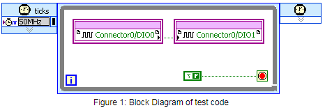

Why does my FPGA Digital Output have delay when connected directly to a Digital Input on my block diagram?
Your block diagram may resemble Figure 1:

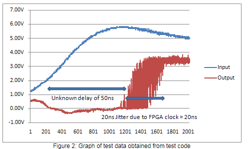

It is likely you are observing behavior similar to Figure 2:
The blue line represents the averaged input pin level, and the red line represents the output pin level. As you can see, the delay between the input exceeding the logic high threshold and the output responding is about 50ns. Propagation delay from cabling is responsible for 10ns of this delay.
LabVIEW FPGA Synchronization registers account for the remaining 40ns of delay. LabVIEW places these synchronization registers in between the FPGA hardware I/O interface and the FPGA I/O node.  Synchronization registers execute in one clock cycle.
