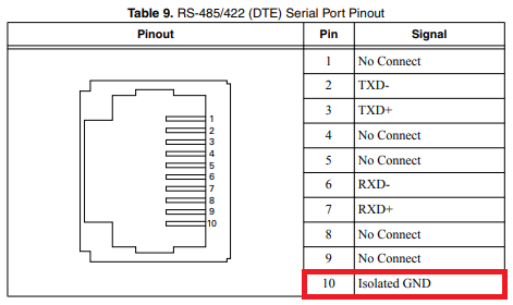

Isolated GND of cRIO-9035 RS-485/422 Serial Port Pinout Pin 10
Updated Oct 10, 2023
  • cRIO-9035
Is Pin 10 of the Isolated ground (GND) connected to the power supply ground?
Pin 10 - Isolated GND in the RS-485/422 Serial Port is connected to the ground of the power supply. This is because the RS-485/422 require a reference for the signal.
Note If you require Isolation, conisder using dedicated optical ioslation modules.
