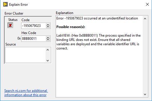

I have a CompactRIO (cRIO) LabVIEW RealTime application in the field that had been running continuously for months without any problems. However, last week I got the error -1950679023, causing the application to stop. Afterwards the application started again without any problem. This happens from time to time and the error message usually disappears after 35-40 seconds.
Here is the error in text:
Error -1950679023 occurred at an unidentified location
Possible reason(s):
LabVIEW: (Hex 0x8BBB0011) The process specified in the binding URL does not exist. Ensure that all shared variables are deployed and the variable identifier URL is correct.
And here you can see an image of the error and its explanation
The error -1950679023 is due to the system that is hosting your shared variable being unable to find the shared variables. This could be caused by:
