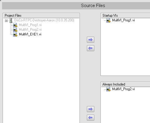

1. VI Server
You can use the VI Server API in your startup executable to run a second (or third, fourth, etc.) VI that resides on the real-time target. To do this, the second VI will need to be copied to the real-time target by either manually FTPing it to the real-time target or by including it in the startup executable. You can include the second VI in the startup executable by moving it to the Always Included section of the Source Files category in the Real-Time Application Properties as seen below:

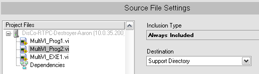

You can then also choose to include the second VI in the Support Directory of the executable as seen below. This will place the second VI in the data folder associated with the executable.
In your startup executable, you can then use the VI Server API to reference and run the second VI as seen in this example code:

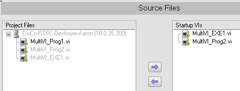

2. Multiple VIs in the Startup Executable
You can also run multiple VIs simultaneously on a real-time target by including multiple VIs in the startup executable. This is done by moving the desired VIs to the Startup VIs section of the Source Files category in the Real-Time Application Properties as seen below
Then build and deploy the startup executable in the normal fashion to run both VIs simultaneously.
