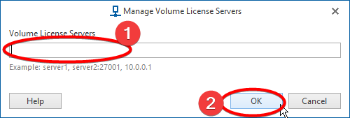

NI License Manager 4.x
  1. Open NI License Manager by going to Start»Programs»National Instruments»NI License Manager.
  2. Click the menu icon close to the top-left corner of NILM's window, then click Manage Volume License Servers:
  1. Remove the name or IP address of the Volume License Server(s) in the dialog window popping up. Confirm by clicking OK.

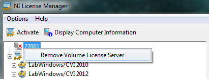

NI License Manager 3.x
  2. The license server will be seen in the license tree above the Local Licenses. Right-click onto the license server and select Remove Volume License Server:
