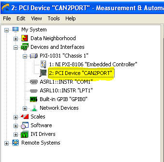

When I insert my PXI card into my system, it appears in NI Measurement & Automation Explorer (NI MAX) as a PCI card.
When a new card is inserted into a PXI system, the Window OS will detect it and assign a driver to the new device. In this case, Windows has assigned a PCI driver to the PXI card. This is why the the card is showing as a PCI card.

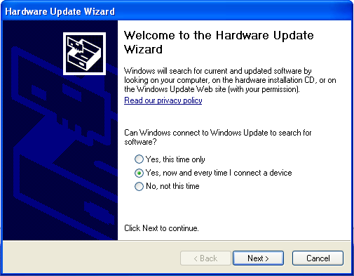

  3. Right-click on PCI Device » update driver. A new window Hardware Update Wizard will open.
  4. Select Yes, now and every time I connect a device and click on Next.

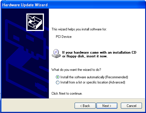

  5. Select Install the software automatically (Recommended) and click on Next.
  6. Wait for windows to search for the correct PXI driver and click on Finish
Now you can see in both Device Manager and MAX, the newly-inserted PXI card is showing as the correct name.
