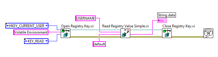

I'm reading registry values and am getting error 603 after moving my code from Windows Server 2003 to Windows 7. I was previously looking for "logon user name" key located at the following path using regedit.exe:
HKEY_CurrentUser\Software\Microsoft\Windows\Current Version\Explorer\logon user name
In Windows 7, it looks like this path/registry key does not exist. Where is the "logon user name" key now?
Microsoft changed the registry layout between Windows Server 2003 and Windows 7. In Windows 7 the registry path for the user name registry key is the following:
HKEY_CurrentUser\Volatile Environment\USERNAME
Modify your registry read function to look similar to the block diagram below.
