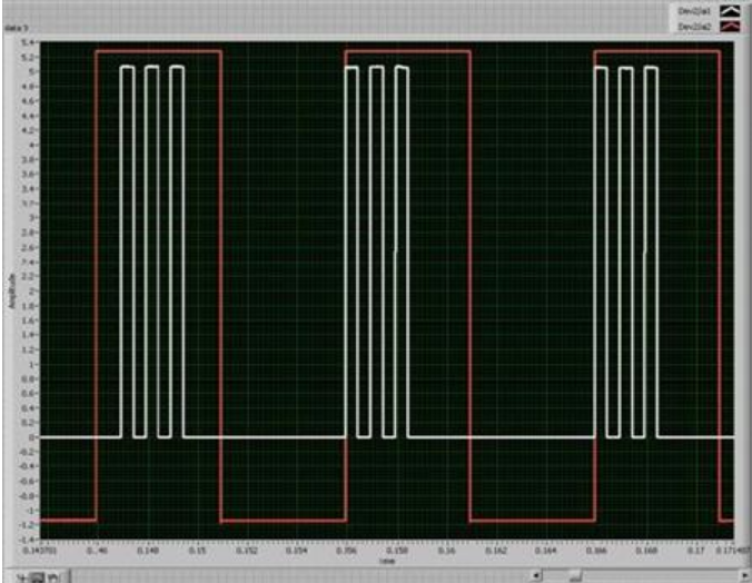

You will need to use two counters on older chipset devices. Configure the first counter (ctr0) to generate a continuous pulse train on its OUT pin. This pulse train is then gated by the second counter (ctr1). Using the DAQmx Trigger property node, you can configure the continuous pulse train to pause when the internal output of the second counter goes low. This means that the only visible pulses will be when ctr1 is high, which is gating the continuous pulse train to be configured as a finite generation.
The figure below illustrates an example of how to do the described solution. The number of pulses that will be seen is configured by dividing the number of desired pulses (5) by the frequency of the continuous pulse train (1000 Hz). This gives a high time for the gating counter of 5 ms. The low time is also configured to be 5 ms. This means that when the trigger is received, which is PFI 1 in this case, there will be 5 ms of low time on the gate before the 5 pulses are seen. This effectively creates a delay for each retriggerable generation.
