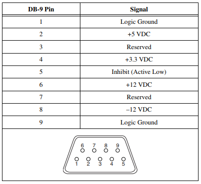

You can turn ON/OFF your PXIe chassis if it has an Inhibit Switch in the rear panel. You need to move the switch from Default position to Manual Mode to bypass the controller and enable the power supply. Then you can power ON the chassis. If you want to power off the chassis, you can use the Inhibit signal (active low) on pin 5 (see image below) of the Remote Inhibit and Voltage Monitoring connector to power off the chassis.
