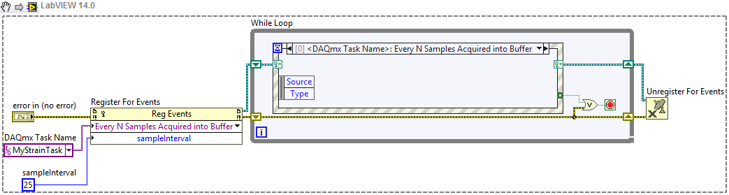

  • In case you are doing a triggered finite acquisition, you can register an Event that happens after every Nth sample has been transferred from the DAQ device to the PC's buffer. Use DAQmx Create Event.vi to do so.
