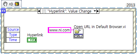

I want to have a hyperlink on my front panel that will launch a separate web browser on my front panel when I click on it.
Use the Open URL in Default Browser VI
This VI can be found in the Functions»Dialog & User Interface»Help palette in LabVIEW 2013-2017. It takes in the desired URL as a string and opens the website in whatever browser is set to the default for that computer. As such, it may behave differently on different deployment machines.
