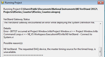

I am trying to set up a counter input task in my VeriStand project using an X Series DAQ card, but see error -307727 when I try to deploy the project.
What is wrong with the timing source in my project?
This error is occurring because your counter input task is looking for the sample clock source on the Trigger lines of your DAQ card, and you do not have a remote clock being passed into your X Series device.
If you do not have a 2nd device that can provide this sample clock, then you can use the analog input sample clock on-board your X-Series device by setting up a dummy Analog Input task.

  1. Now that you have set up an analog clock, return to your counter task and set the sample clock source of your counter task to "ai/SampleClock"
You should now be able to successfully deploy a single-point counter input task that works for measuring frequency and duty cycle of pulses.
