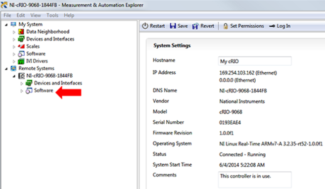

  • Open MAX and expand the [+] next to the CompactRIO device under Remote Systems like below figure 1
Figure 1. Remote System and CompactRIO software
