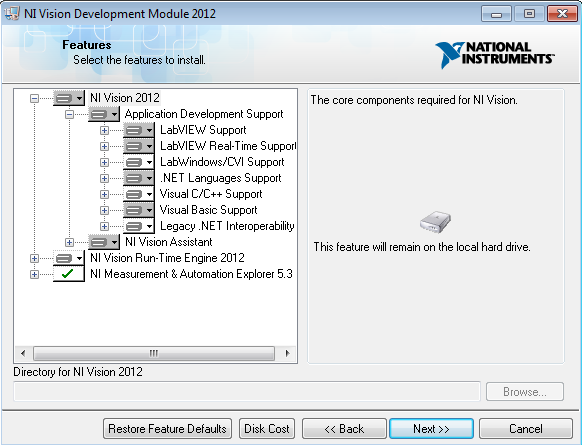

First Time Installation
  1. On the Features page of the VAS , VBAI , or VDM  installer, expand Application Development Support.
  2. Select the the desired support based on your application development environment and set it to Install this feature to a local drive.
You can expand the specific type of application development support to see the exact support files are installed for your programming environment.
