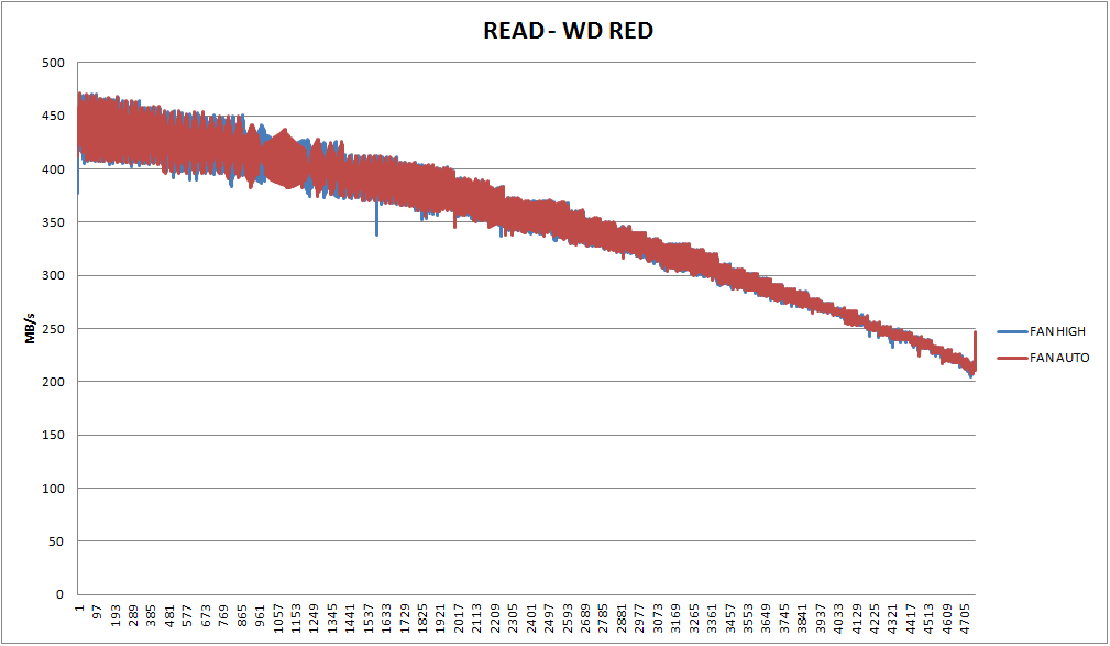

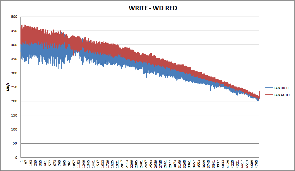

  • The NI 8261 HDD performs best in a PXIe-1085 with fans set to Auto. With fans operating on High, performance is degraded due to increased vibrations. The below graphs depict performance versus fan speed. Whenever possible, install the NI 8261 HDD in slots 2-6.
Figure 1. NI 8261 HDD write speeds versus the amount of data stored in the HDD
Figure 2. NI 8261 read speeds versus the amount of data stored in the HDD
