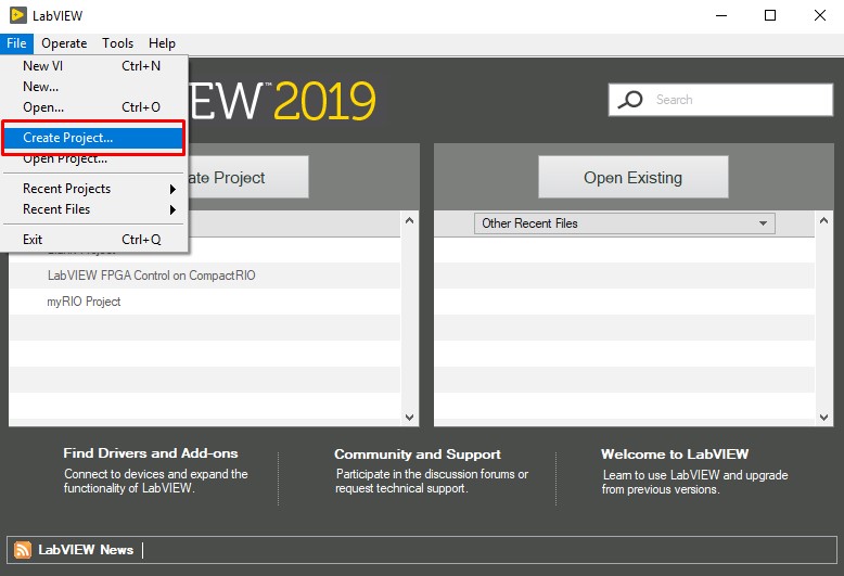

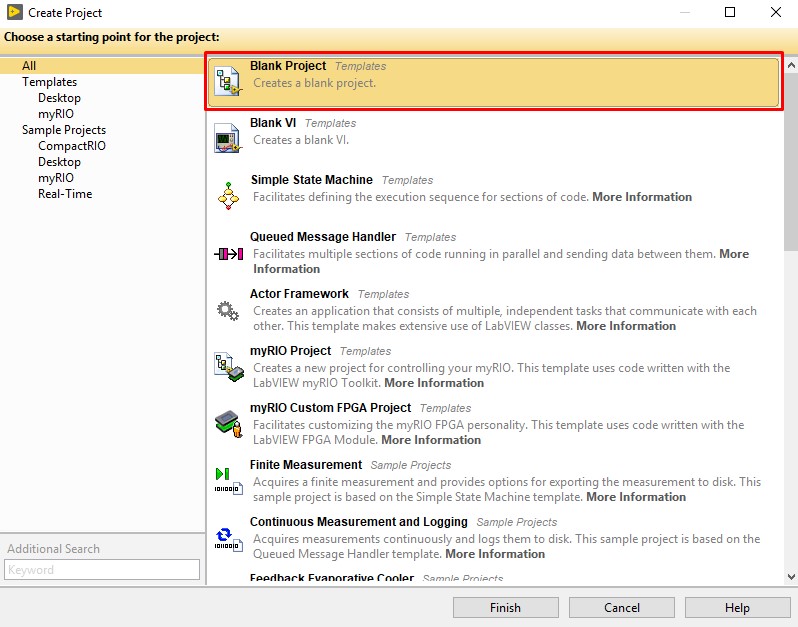

  2. Create a Blank LabVIEW Project

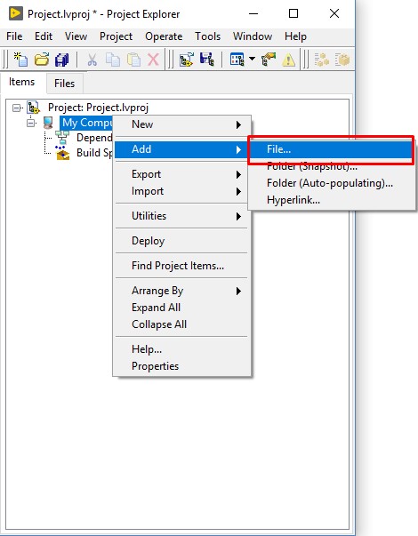

  1. Add your .EXE file to the project, under My Computer

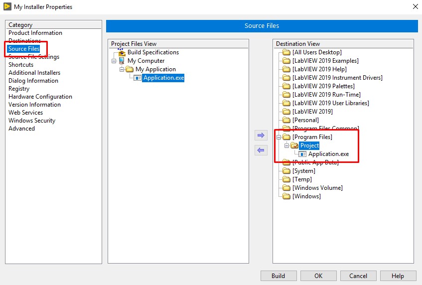

  1. In the properties window, configure the Build specification nameProduct nameInstaller name and Installer destination.
  1. Select the Source Files category
  2. Add your executable to the Destination View in the location desired

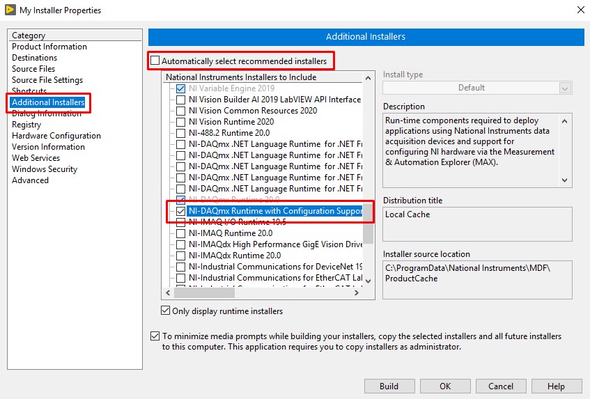

  1. Select the Additional Installers category
  2. Uncheck the Automatically select recommended installer box
  3. Select the NI-DAQmx Runtime with Configuration Support, and the other required software you consider is needed for your application to run
Note: Make sure you select the correct .NET language runtime and Framework versions, according to the characteristics of your C# application.

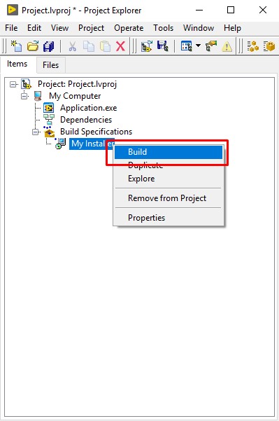

  2. Right click in the Installer and select Build
  1. When the build finishes, select Explore to open the folder with the installer file.
