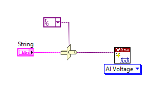

  • If your device name comes from a string data type, use the Type Cast Function to change the data type. Also make sure that the device name is correct as explained in this document: NI-DAQmx Syntax for Specifying Physical Channel Settings.
