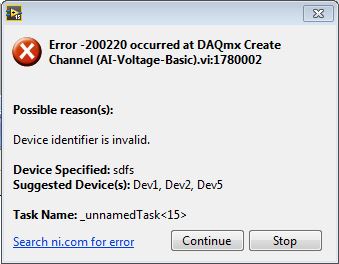

I recently changed or added new hardware to my data acquisition system using NI-DAQmx and now I'm getting the following error when I run my VI or executable:
Error -200220 occurred.
Possible reason(s):
Device identifier is invalid.

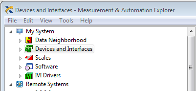

  • This error message can be caused by having the wrong device name. Follow the steps below to ensure the name given to the hardware in NI Measurement & Automation Explorer (NI MAX) matches the name of the device name being specified and used in your application.
  1. Open MAX and expand Devices and Interfaces in the left-hand pane.
    • If you are using a NI Real-Time Controller that has a DAQmx device connected to it, find the Real-Time Controller under Remote Systems and check Devices and Interfaces under the controller.
  1. Find your desired hardware and take note of the name in quotes. Alternatively, right-click and rename the resource to the DAQmx alias name that is used in your LabVIEW or application. Click Save in NI MAX.
  1. In LabVIEW or your application, ensure the name used in your DAQmx VI function calls match the alias name in NI MAX. By default, the drop-down menu for DAQmx physical channels will only auto-populate with valid names in LabVIEW. For other application development software verify the alias' match.
  1. If the names in DAQmx still do not seem to match, programmatically find what the device names are.
