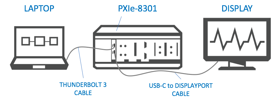

The second Thunderbolt™ 3 port on the PXIe-8301, PXIe-1083, and PXIe-1090 is meant for connecting peripheral devices only (e.g. monitors, external drives, headsets, USB sticks). It is not intended to daisy-chain multiple PXIe chassis together using Thunderbolt.
You can add another Thunderbolt 3 or USB-C device to the system, like a monitor or storage, as shown below:
Note – Either port can be used to connect the PXIe-8301, PXIe-1083, or PXIe-1090 to the host PC.
NI does not support using the secondary Thunderbolt port on the PXIe-8301, PXIe-1083, or PXIe-1090 to connect another PXIe Chassis, as this may cause the system to require more PCIe Buses than the maximum allowed by the Thunderbolt Specification, resulting in unexpected behavior.
