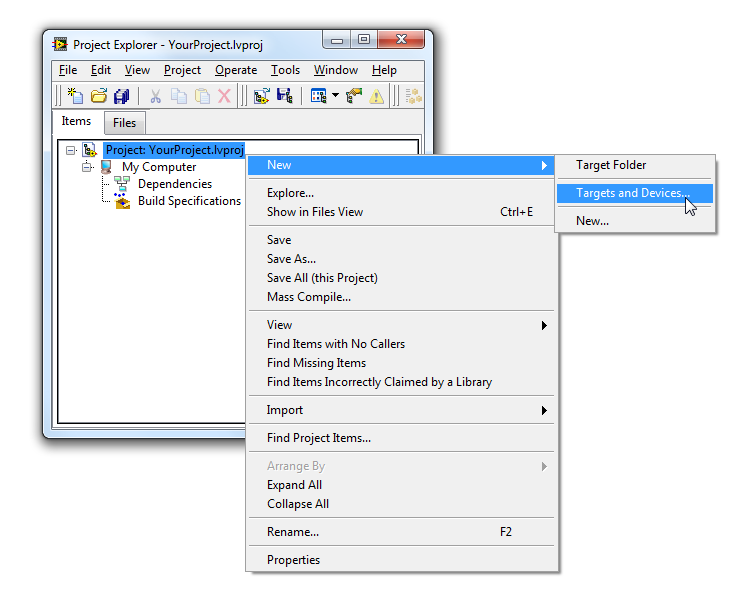

- You might be getting a screen with limited hardware options because you are trying to add a device under My Computer, whereas the cRIO, sbRIO or any real-time target must be added under the Project in the project explorer. Follow the below steps to add your Real-time Target in your LabVIEW project explorer:
1. Make sure your Real-Time device shows up in Measurement & Automation Explorer (MAX). It will show up under "Remote Systems"
If you cannot see your target device there, refer to one of the following KnowledgeBase articles discussing possible steps to allow you to discover your target.
2. Create a New LabVIEW Project.
3. Open your LabVIEW project and right click on the "Project:" entry.  Go to New >> Targets and Devices...
4. Add your device into your project
