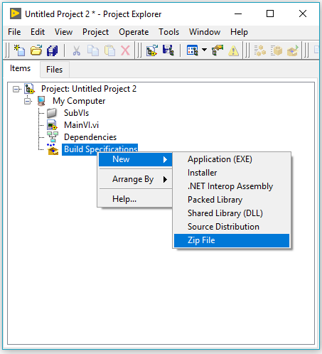

I want to transport my project files to another location, but not all the dependencies are included when I copy the project folder. How can I transport my project and all of its contents in one file?
One simple way to transfer your project file and its contents is to use a zip file, which will compress them to save disk space:
1. Open your project file (.lvproj) and right-click on Build Specifications.
2. From the menu, select New»Zip File and left click on this as shown in the image above. A pop-up window should appear called My Zip File Properties.
3. On the left, there are four options in the Category box. Zip information will be the default category displayed first and you can use this to assign a name to your build specification using the Build Specification Name box. For example, the image above shows the name as My Zip File. You can also choose the location on disk to where this will be saved in the Destination field, as well as adding comments in the Comments field.
