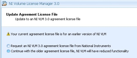

  4. During installation, the Getting Started Wizard will run.  If you do not have a new license file for VLM 3.x, you will see the following warning:
    If you choose to request a new agreement license file, National Instruments will send you an email with this new license file.  Alternatively, you can still use a valid agreement license file created for VLM versions 2.x or earlier with VLM 3.x.  However, you will not have full access to some VLM 3.x features.

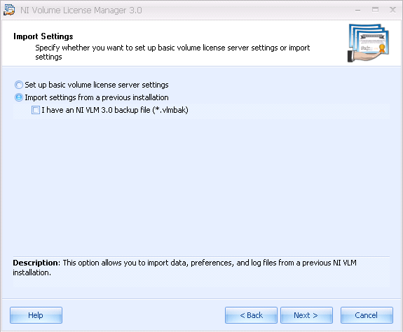

  5. Next follow the steps in the Getting Started Wizard.  Upgrading VLM should have automatically caused your configuration and log file to be integrated with your new version of VLM.  However, if there was an issue finding these files during upgrading, you will see the following screen in the Getting Started Wizard:
    Select Import settings from a previous installation, but do not check I have an NI VLM 3.x backup file (*.vlmbak).  This will bring up a second window:

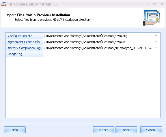

    The Configuration File, Agreement License File, and Activity Compliance Log fields are required.  Click on the ... button to the right of each field, and navigate to the appropriate files. Then click Import and complete the remaining steps in the Getting Started Wizard.
