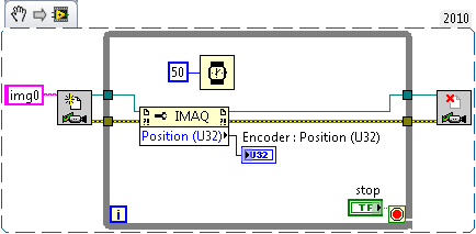

Wire the encoder to the Camera Link I/O Extension Board as described in the User Guide linked below. You can test the wiring by running the following VI (as shown below) for your frame grabber. While this VI is running, spin the shaft connected to the encoder and verify that the position indicator updates appropriately. You should be able to turn the encoder shaft one revolution and see the position change by the number of counts per revolution listed by your encoder specifications.
