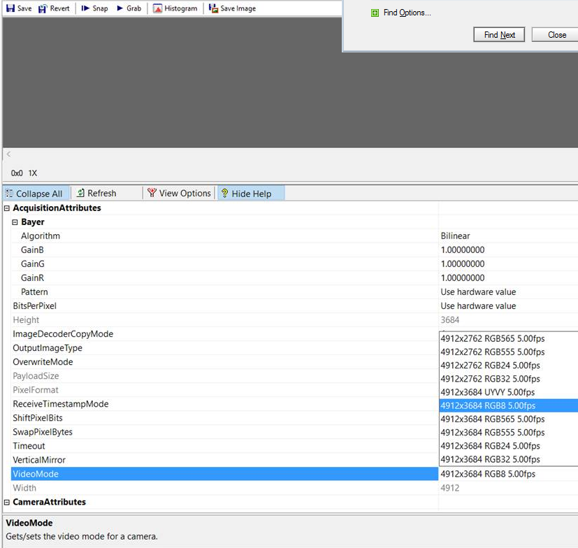

- If you run into this error, try changing the VideoMode to one that is compatible with your camera, within the acquisition attributes in MAX (shown below).
- If you are unsure what Pixel Formats or Video Modes are compatible with your camera, consult the manufacturer's specifications.
- If you get this error after changing the pixel format, please double check the acquisition attributes, such as data output format bitness. It can automatically reset after changing the pixel format.
