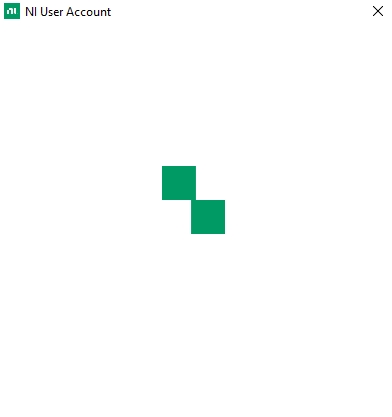

I cannot activate my software within NI License Manager (NILM) 4.0 or higher.
  • Run NI License Manager as 'Administrator'.
  • When I click on Log In a popup window flashes and disappears before I can enter my NI account information
  • The NI Activation Wizard hangs at checking my user account and it is not possible to skip this process.
  • When I click on Login to activate a popup window with NI site comes up and there is no way to provide my credentials
