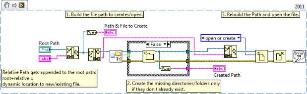

You can also programmatically create the folder if it is not found as shown below. This example is also posted as an example on the NI Developer Community.
